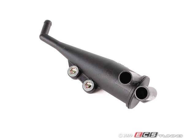

I use two of these  with the bottom cut off sitting inside a tank with fuel tank foam.
the base of the tank has a ball valve on it so at the track I can leave it open to drain to sump and all other times it just collects in the tank and I clean it before a track day because it gets sludgy due to moisture over time.
