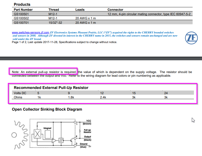

Does anyone else run an inline resistor like the sensors are designed to have? I don't and get some weird rpm bounce on logs during transition from acceleration to overrun. Doesn't make a difference as there isn't really any need for accuracy there but still a little annoying. I'm going to try and resistor and see if it fixes it
Yes. I run a G4+, previously with the internal pullup. Just the other day I wired in a resistor and turned off the internal pullup.
Car still starts and trigger scope looks good, but that is no different to how it was. Haven't had a chance to drive it and log yet.
ECU pullup is 4.7K, sensor asks for a 1K @5V. My sensor runs 12V so from memory I used a 2.2K or something.
I'd be surprised if that's required. as long as you set the trigger edge to falling it should be a consistant signal.
signal rise time is what they're trying to keep down with the lower ohm pullup. im guessing that the Cherrys have an unusually high capacitance if you need that much.
Yes, those published specs will be for a rise time suitable for the rated freqency of >10khz using cherry's recommended tooth profile.
10krpm on a 12 tooth crank trigger is only 2000hz so nowhere near that. Happy to be shown a scope trace to be proven otherwise.
But if this pull-up change has fixed your issue I'm happy to suck eggs, and is likely do to having excessive capacitance or very high resistance somewhere in your wiring.
But Sure, if this was a 60-2 wheel then by all means 1k is a good idea.
