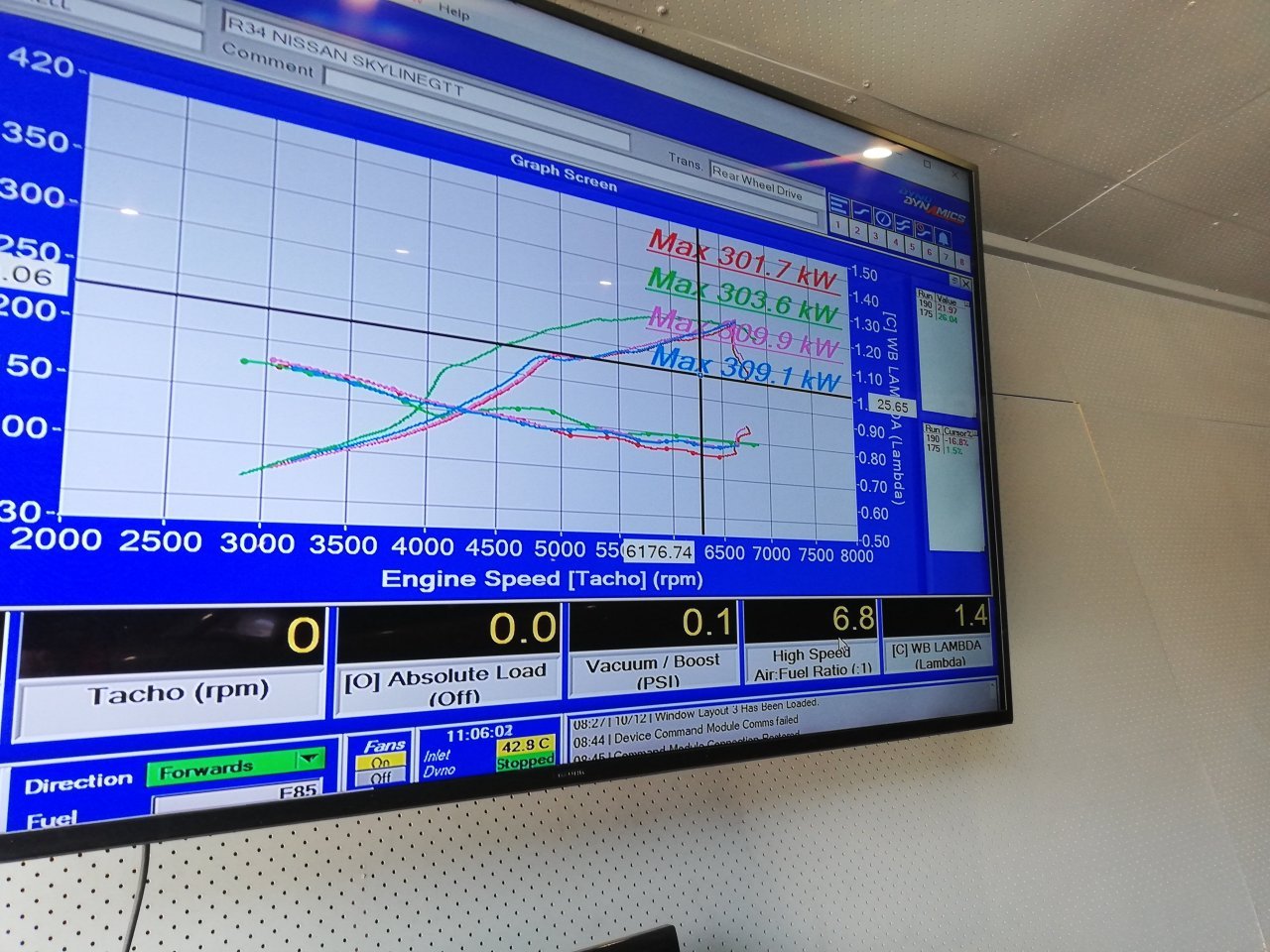

Perfect example of using a short runner manifold vs standard. The only thing I would use is the plazmaman plenum which bolts to factory runners.
