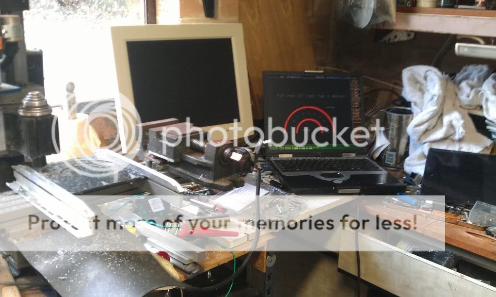

Here are some more build pics
CNC machine making surrounds
What they look like before install
underbody coat to protect wiring and joins from the elements and corrosion etc, plus it looks nicer.

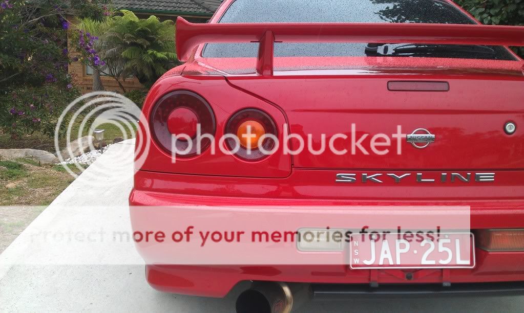

does the black backing make the lights look 'tinted' when they're not on? have you pulled apart a Nismo set? do they mount on black backing? i've got the Qest ones, they look great and are made very nicely but back is too light, i want the OEM look like Nismo.
I take it these are brighter than Nismo?
Depending on how close the discs are mounted, you don't really notice anything, the better option is to spray them RED, or Silver and they are seemless, our old kits used a fairly heavy silk-screened and soldered board, but the larger one had to be mounted further back to avoid uneveness in the LED ring (you'll notice some kits go blurry for about 25% of the ring where they're not parallell to the red lens)
Hey Daniel I just went outside and took a photo so you can see for yourself, I dont think they do and look as per factory minus being able to see the LED's which is exactly the same as genuine nismos as I was lucky enough to have a friend with a set that let me get nice and close to look at it all but didnt pull it apart as we were far from home.
I will try and mount the boards further back for some people if they prefer to hide the LED's a bit as my set are basically a test set till I buy another set of lights to 'experiment' on
here you go
