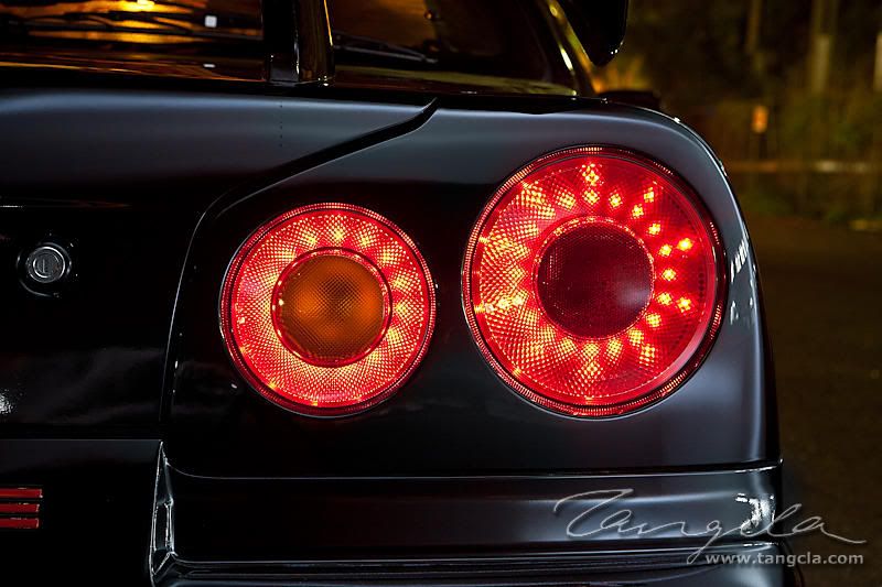

stock tail lights are def do-able as there's a guy in japan (yahoo auctions again) that sells nismo-lookalikes, basically stockies with leds inserted into them.
Having said that, I've just recently taken a look myself when I was replacing mine with the eastbear copies .. and the lens is glued on there with some sort of silicone + clips all around, so it'd be a bitch to remove. But maybe with some patience and a spare set to fall back to ..why not try. But then you still have to do the whole leds thing....arrrg. Might be cheaper just to sell the stockies and buy the ones from japan which came to about $600 delivered iirc.

yeah, he's taking the stock tail lights apart and putting LEDs in. Looks like you need a heatgun to separate the lenses which would confirm what I saw when i took mine apart recently ..the lenses are glued on real hard with some type of silicone.
Too much of a hassle to be honest ...just get the eastbear copies off ebay ($330 or so) if you want LED tail lights. I got those and just painted the blinker to amber as I hate the clear plastic crap on any tail lights

I've replaced mine the other day with the one from opening post from Japan ..looks awesome.
Only issue is when removing the housing some of the old seal cracked away as it was all hard and shit .. It's actually not seal it's some sort of black gunk, like playdough/bluetack. So I need to buy some more of this shit to fill all the gaps nicely so as not to allow water to come in from the outside and give me that dreaded "rust around bootlid tail light on R34" look..
Any ideas what this black gunk is called? It's soft and sticky and black ..like playdough but stickier..
Yeah best bet is to leave the red section in place and unclip the rear of it (heads up for all other people) not sure what they call that stuff.
that black gunk type paste your talking about im pretty sure is what we use at volkswagen, its called Sikaflex. really good stuff that.
and in case you want some piks of the exact setup for the led nismo taillights, as i have genuines in mine, here are some piks:
dan, i will take the boot lid brake light insert and both the red and white leds for the reverse
yeah and those that take it out and ruin that factory seal like I did ..grab a small tube of Bostik (the black one) from bunnings. It's black silicone and costs $4 .. real easy to apply around the edge from the outside, then wipe all excess off and let it dry. Perfecto :P
