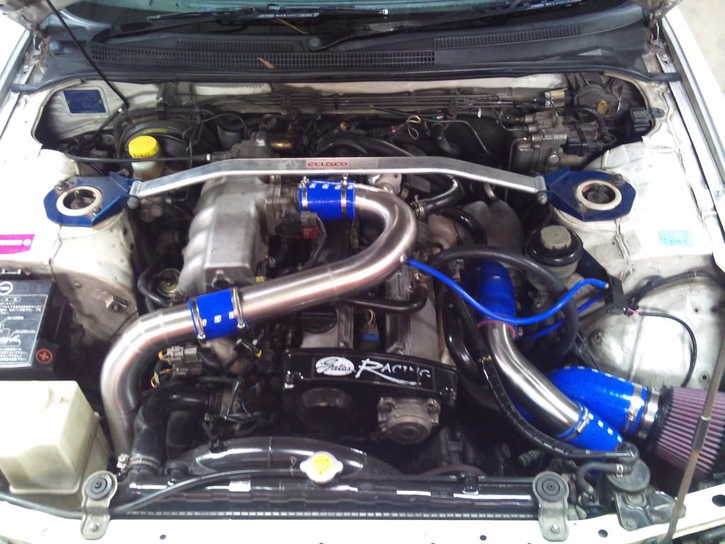

Im gunna blow my own trumpet here and say that i think my custom fabricated pipework is a better setup as it is shorter and doesnt run near the radiator and doesnt have as much pipework running over the top of the rocker cover which means it should be less prone to heat soak and is short as possible without a forward facing plenum which = more $$$%3ca%20href=DSC_0709.jpg">

Im gunna blow my own trumpet here and say that i think my custom fabricated pipework is a better setup as it is shorter and doesnt run near the radiator and doesnt have as much pipework running over the top of the rocker cover which means it should be less prone to heat soak and is short as possible without a forward facing plenum which = more $$%3ca%20href=">
That sure is some tidy work, you don't live in Brisbane by any chance? Have had a brief go on tig welder myself and can appreciate your work.

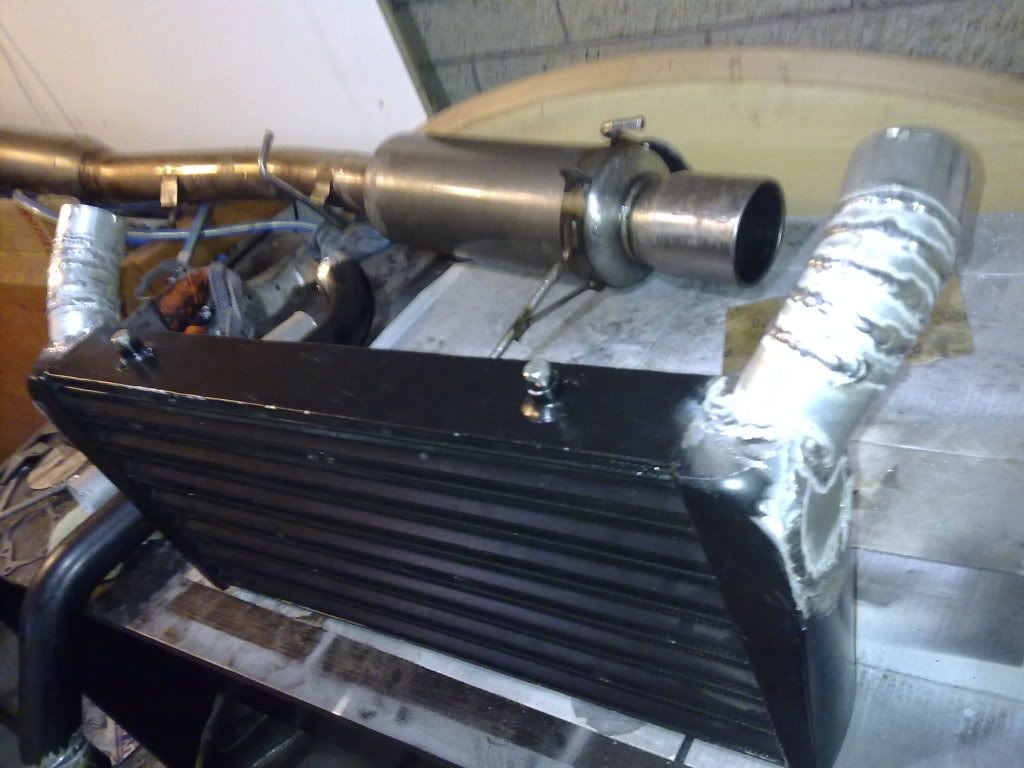

I went full retard... :whistling:
ended up costing as much as a new Bitz return flow for probably half of the effect, I have an IAT sensor now so I guess i will now how good/bad it is soon..The only real benefit to doing it this way is when your missus ditches your car off the road in the dirt you can drive home cause you didnt destroy your intercooelr in the process, oh and I didnt have to cut my reo..other than that its just f**king retarded :laugh:

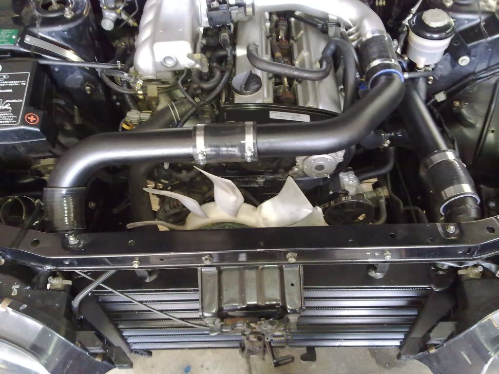

^ The radiator is in place, the cooler piping fitted around the core. Just. There was plenty of die grinding involved with getting the flow in and out of the cooler tanks as I remember but it was worth it for the response gained.
Edit: Ahh, didnt see the lack of rad. >_<

Do u have a photo of how it sits with the radiator in place?
Did u cut holes in the rad support ?
