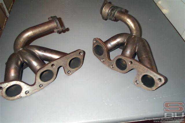

HKS Bridged Low Mount Manifold
I swapped to the bridged manifold in order to help reduce compressor shuffle of the big GT-RS low mount terbs.
Although not done at the time of the photo, I have since had these ceramic coated in order to help reduce underbonnet temperatures.
