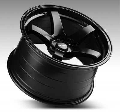

hey guys, Just looking at getting a new set for my 34, currently have 19x8 +35 with 235's all round.
I wanted to get some koya drift teks but they only have 18x9.5 available at the moment, a couple of tyre shops have said they'll make them fit no worries, but I'm not to keen on having huge aggressive fitment on the front, I just want them sitting flush.
So Im leaning towards getting concave concept CC03's in 18x9 +20 with 235's all round, would I need guard work? not a big deal if I do, the shop will roll them for free anyways. what do you think?
with the 9.5 youl want around a +32/35ish off set for them to sit flush but then you may run into issues with clearing suspension arms on the front.. and most likely be limited to a max of a 235 tyre on the front... and possble scrub if your cars lowered to much.
on the other hand. 18x9 +30 is the sweet spot for all unmodified guard work on gtt, that being said +20 would sit 1cm further out the arch so more aggressive.. and id run at less a 245 Tyre on a 9" wheel unless you want a tiny bit of stretch. but if you do go with the +20 offset stretch em tyres or your gonna have a scrubing time :)
haha cheers, yeah Im thinking the 9's in +20 would sit heaps nice with a bit of stretch. the only other option is a set of dtm p5 wheels (a replica of the drift teks which are a replica) I found in 18x9 +25 so thats kind of a happy medium I guess?
no its just a toss up of what ooks better, that drift tek sort of style or concave concepts. any opinions?
