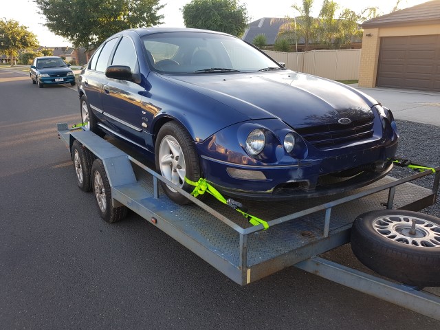

Behold, the beauty of my AUII XR6! Won't bother starting new thread, will be pretty obvious which car is which when updating.
First event for the Silvia is still months away and as I wanted to get into some dirt action this year, and get my partner involved, I'm going to have a crack at a few motorkhanas, hopefully starting with a tarmac event this weekend as a shaekdown, if I can get the car sorted.
Lots of dodgy shit on this car but it is RWD, manual, and has a fat exhaust and a pod filter so we're good.
Missus spent some time cleaning the filthy interior while I toiled away on the other stuff. Car drove home (working AC and cruise!) so it's not "that" bad, but it needs some love. Actually, yes it is that bad.

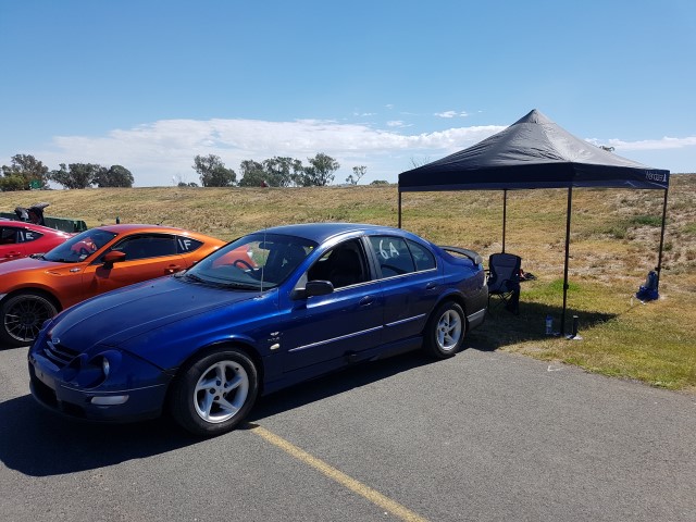

Well that was quite a day lol Had a lot of laughs learning how to captain this vessel.
Start with the bad, then onto the good - and there was plenty of good :D
The bad/issues.
  • Tyres were just terrible, watch the video to see what I mean. They had a 1-2 lap window at best. I played with pressures which reduced the window but gave me more outright grip in that window. They will be fine for dirt, so they stay.
  • Power steering fluid spat out all over the extractors, turns out it was massively overfull so that was an easy fix but the bulk smoke that entered the cabin was a little worrying!
  • Clutch pedal stayed on the firewall a few times, car doesn't like being rushed into gear and seemed to only happen when i was heel toe double clutching really fast, so avoiding that was enough - should be fine for dirt as well.
  • Seat is terrible, you have to hold on for dear life lol Will get 2x race seats and harnesses on the cheap.
  • Suspension is ridiculously soft, will be great for dirt I think but it struggled on the tarmac.
  • Diff seems a little tired, you can tell by the way it's pushing/kicking around that it's struggling. In the video you can see it seems to only spin 1 wheel decently when I lose it. Should be OK on dirt, but we'll see if a mini spool is needed.
  • Can't find where the fuel smell is coming from.

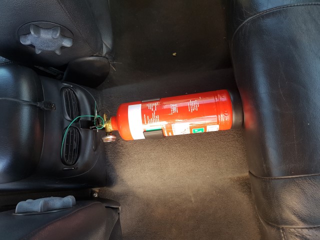

  • This club mandates a fire extinguisher, had to rush home and grab my spare and some tools. Could only mount it on the trans tunnel as that was the only place my 50mm+ self tapers could reach the floor pan lol Lucky I;m only 10mins away from this track.
Now the good.
  • Brakes weresurprisingly good, no fade and decent stopping power for what they are, ducts no doubt helped. Having shit tyres also helps keep speeds down.
  • Managed to get a good 2sec off my time over 4 sessions and chopped an SS (to be fair, the dude had only done 3 track days ever but it still counts, 4 seconds... chopped!).
  • Car just kept taking punishment all day, didn't boil coolant, brakes, no obvious heating issues despite 35deg temps and I wasn't kind to it.
  • AC in the pits was lovely.
  • Boot is monstrous and fitted ALL my gear including the gazebo lol
  • Steering wheel is actually decent to use.
  • Car seems surprisingly good on fuel, barely used half a tank of top shelf 91 octane.
  • Car is just a hoot to drive, exhaust, suspension wallow, vague as gearbox, should be a blast on the dirt.
Cannot wait for the first dirt event, which is late April. In the meantime there's 2 rounds of the sprint series for me to attend with the Silvia once I fix that coolant line. I wont change anything else aside front tyre pressure as I want to see what those AR-1s can really do.
