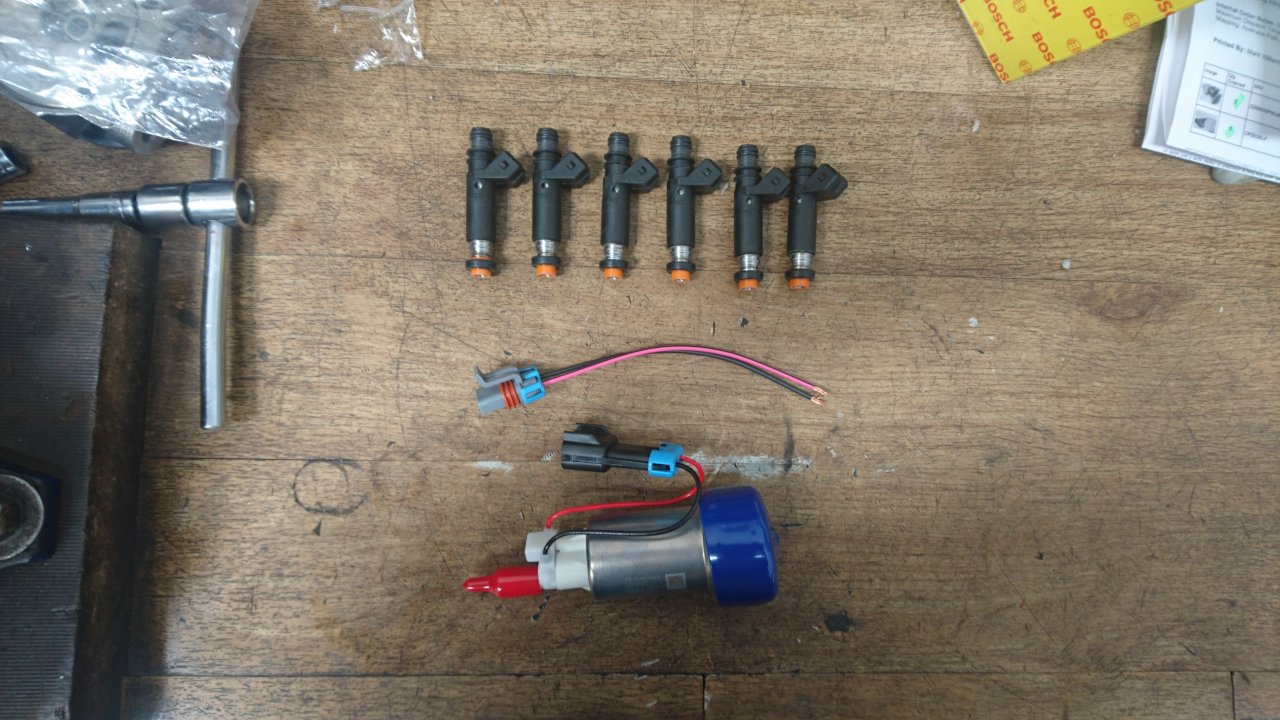

I guess some of yous already seen, we've started modding RB20det for the next couple of week and see how far we can get before hurting driving ability.
So the car is an 93 model GTS-4, good condition and solid. Its fully stock with an cat back exhaust and a blitz return flow cooler only. Its running a R33 GTST turbocharger at 10psi and it is as slow as it gets.
So far I've ordered:
Split fire coil packs
Z32 AFM
470L Walbro pump
JJR front pipe with 100 cell cat
650cc Siemens injectors
Nistune ECU
The first turbo I will be fitting will be an ball bearing ATR43SS-1.

For the amount of exterior work is not bad. It used to be Jesse Customs personal car two years ago. any way, parts started to arrive and I will update with prices and places.
I'm using siemens 610cc injectors @ $60 each and Walbro 470L pump @ $200 each from Injectorsonline . com
Z32 AFM and plug cost $250 from Dev industries

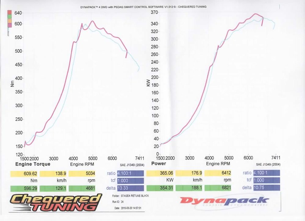

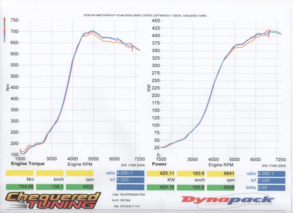

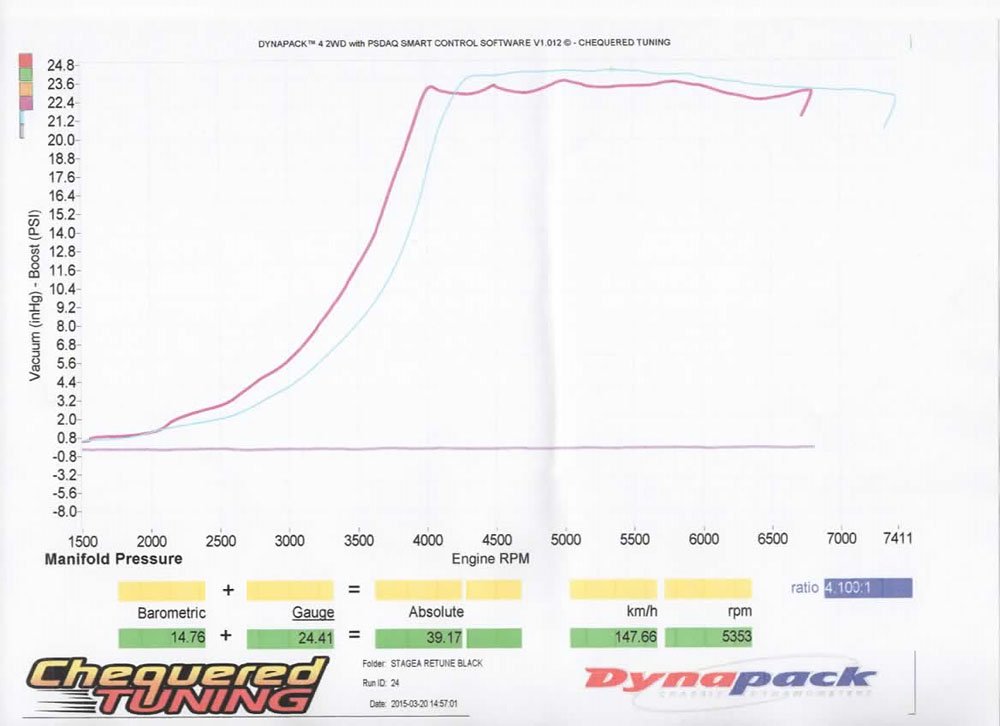

On 18/08/2016 at 2:48 PM, hypergear said:
Here is one more result that are worth posting.
This is from one of my troubled customers whom like many others using stealth setups including a return flow cooler and a silent exhaust. Obviously it made a petty 260rwkws P98 using our ATR43SS2 turbocharger with a massive boost drop. The SS2 however have held a dead flat 20psi on my R33 peeking 302rwkws. Fixing that boost drop problem, he went all the troubles fitting up an External gate that made only a 5kws gain. His disappointment anger and frustration has been directed to the turbo and my self.
During that time, initial ATR45SAT was first made and tested by Havoc Fabrications at 420rwkws. An upgrade request was made by the customer so the same turbo was built and sent for the exchange of the ATR43SS2 which I'm yet to receive. With nothing else apart from the turbo change and E85, the car made an disappointing 354rwkws, that have sparked more heated conversations, to prove my product I have later managed to use the same turbo beating his E85 result running internal gate on less boost.
Red- My internally gated result vs Blue - under performing externally gated result
Finding out reasons and answers in solving those issues, I have bought my 2nd and 3rd R34, picked the exact same mods used, guess what I ended up with same crappy result. Investigation pointed to the Blitz return flow cooler, the 2.5 inches resonator inside Jap exhausts as well as the EPA approved compliance cat, test results of those are documented in my earlier updates of this thread.
A proper front mount cooler is finally fitted, with a good cold air induction system and a free flow exhaust installed. using the same turbocharger the car has now hit 400rwkws on E85 fuel:
Vs controlled result:
This is an perfect example of how important it is picking the right supporting and differences it makes to overall performance.

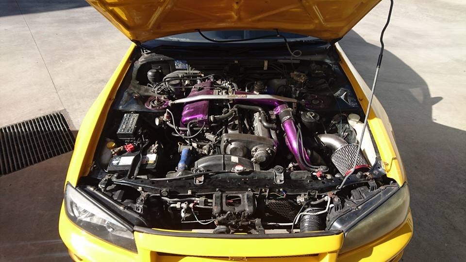

What make is that airbox please?
^ looks like a custom CAI box to suit factory snorkel
